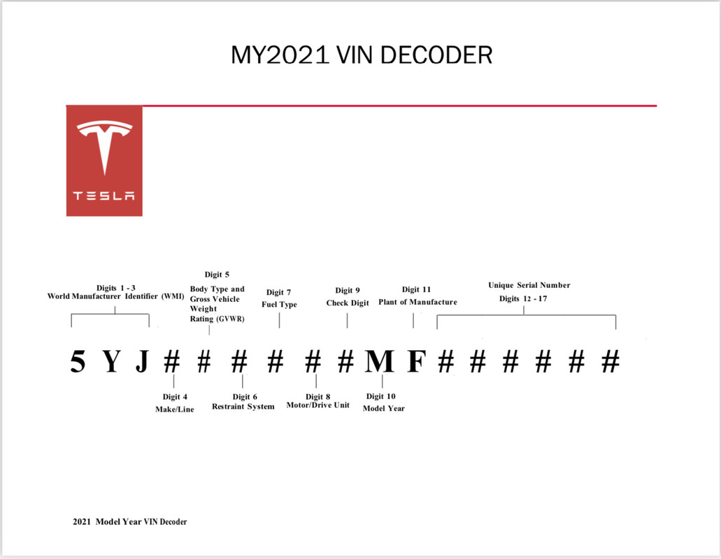

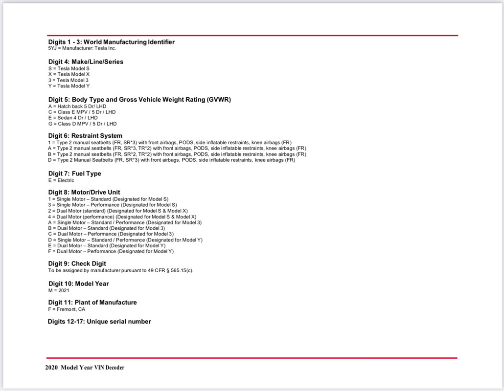

En complément voici de quoi comprendre nos VIN :
Digit 1 – 3: Manufacturer code
5YJ = Tesla Inc.
SFZ = Roadster, which were manufactured in England
LRW = Tesla China
Digit 4: Modell
R = Roadster
S = Tesla Model S
X = Tesla Model X
3 = Tesla Model 3
Y = Tesla Model Y
Digit 5: Chassis Type and “Gross Vehicle Weight Rating” (GVWR)
Roadster : E = Convertible
Model S : A = 5 Doors (Left-hand drive)
Model S : B = 5 Doors (Right-hand drive)
Model X : C = Class E (6001-7000 lbs) GVWR / MPV /5 Doors (Left-hand drive)
Model X : D = Class E (6001-7000 lbs) GVWR / MPV /5 Doors (Right-hand drive)
Model 3 : A = 5 Doors (Left-hand drive)
Model 3 : B = 5 Doors (Right-hand drive)
Model 3 : E = 4 Doors (Left-hand drive) Sedan
Model 3 : F = Sedan 4 Door (Model 3, Right-Hand Drive)
Unknown : G
Digit 6: Belt System
1= Manual Type 2 Seat Belts (Front, Rear*3) With Front Airbags, PODS, Side Inflatable Restraints, Knee Airbags (Front)
3 = Manual Type 2 Seat Belts (Front, Rear*2) With Front Airbags, Side Inflatable Restraints, Knee Airbags (FR)
4 = Manual Type 2 Seat Belts (Front, Rear*2) With Front Airbags, Side Inflatable Restraints, Knee Airbags (Front)
5 = Manual Type 2 Seat Belts (Front, Rear*2) With Front Airbags, Side Inflatable Restraints
6 = Manual Type 2 Seat Belts (Front, Rear*3) With Front Airbags, Side Inflatable Restraints
7 = Type 2 manual seatbelts (Front, Rear*3) with Front Airbags, Side Inflatable Restraints & Active Hood
8 = Type 2 manual seatbelts (Front, Rear*2) with Front Airbags, Side Inflatable Restraints & Active Hood
A = Manual Type 2 Seat Belts (Front Row, Center Row*3, Third Row*2) With Front Airbags, PODS, Side Inflatable Restraints, Knee Airbags (Front)
B = Manual Type 2 Seat Belts (Front Row, Center Row*2, Third Row*2) With Front Airbags, PODS, Side Inflatable Restraints
C = Manual Type 2 Seat Belts (Front Row, Center Row*2, Third Row*2) With Front Airbags, PODS, Side Inflatable Restraints
D = Unknown
Digit 7: Type of drive train
E = Lithium Ion Battery – Electric (NMC)
F = Lithium Iron Phosphate Battery (LFP)
H = Lithium Ion Battery- High Capacity (NMC)
S = Lithium Ion Battery – Standard (NMC)
V = Lithium Ion Battery – Ultra High Capacity (NMC)
Digit 8: Motor Type
1 = One Motor – 3Phase Alternating current induction
2 = Two Motors – 3Phase Alternating current induction
3 = One Motor Performance – 3Phase Alternating current induction
4 = Two Motors Performance – 3Phase Alternating current induction
B = Two Motors – Further details unknown
C = Base A/C Motor, Tier 2 Battery (31-40 kWh)
G = Base A/C Motor, Tier 4 Battery (51-60 kWh)
N = Base A/C Motor, Tier 7 Battery (81-90 kWh)
P = Performance A/C Motor, Tier 7 Battery (81-90 kWh)
Digit 9: Check digit
1
Digit 10: Model year
6 = 2006
7 = 2007
8 = 2008
9 = 2009
A = 2010
B = 2011
C = 2012
D = 2013
E = 2014
F = 2015
G = 2016
H = 2017
J = 2018
K = 2019
L = 2020
M = 2021
N = 2022
P = 2023
Digit 11: place of manufacturing
1 = Menlo Park, CA, USA
3 = Hethel, UK
C = Shanghai, China
F = Fremont, CA, USA
P = Palo Alto, CA, USA
R = Research
Digit 12: First digit of the unique serial number of the vehicle
1
2
3
4
5
6
7
8
9
A = Alpha Prototype
B = Beta Prototype
E = Prototyp for Evaluation, Roadster
F = Founder Series Vehicle
M = Mule, Roadster, early prototype
P = Production Vehicle
R = Release Candidate
S = Signature Series
V = Validation Prototype, Roadster
Digit 13-17: Remaining digits of the unique serial number of the vehicle

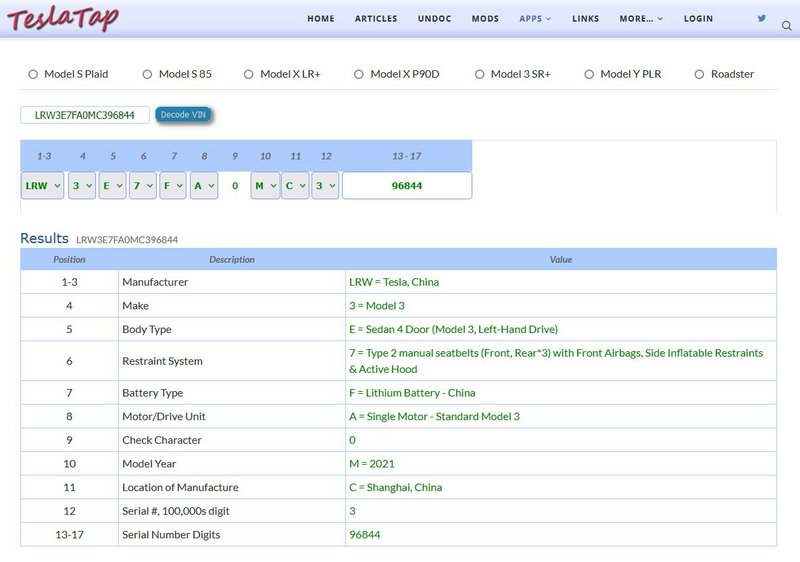

Sinon sur le site TeslaTap site vous faite un copier coller de votre VIN
Pour moi : LRW3E7FA0MC3XXXXX
Dernière modification par slick le 21 mars 2022 19:34, modifié 2 fois.

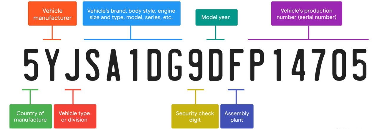

en même temps chez Tesla les options se résument à la couleur de la carrosserie, des sièges, les jantes et les pack de conduite. Par rapport à la bible d'options chez les allemandes
Messages : 2217
Re: Vin decoder Tesla - Model 3, Model Y, Model S, Model X
Le digit 9 Check Caracter, vous savez à quoi ça correspond ?
marc5974
Messages : 1335
Inscription : 23 oct. 2021
Voiture : Model 3 prop 2024
Message par marc5974 »
C'est une clé calculée à partir des autres digits pour vérifier que le numéro de série est correct
Messages : 2217
:Top: Merci à toi.
